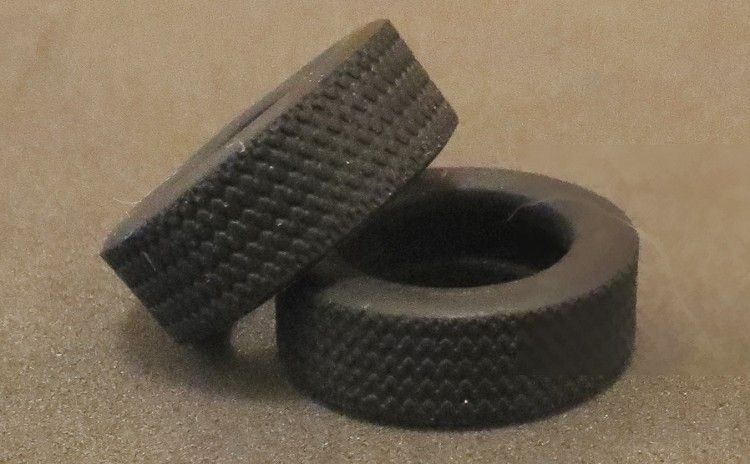

Looking at the business end of the model I note the tyres come with full tread detail. Tyre compound feels to be a rubber of sorts, but we all know by now what happens to Carrera tyres if you use tyre treatment on them don’t we kiddies! The wheels are also two pieces which Carrera have done before, in some cases it is only the tyre sitting on the rim which holds the halves together! I also notice that the rear tyres are 0.5 mil wider than the fronts MMmmmmmm?!
Topping this, and with Verniers in hand, I can definitely confirm that the wheel major step (centre ridge) is at least two centimetres proud of the tyre step. At this stage I am not aware if anyone is making urethanes, but I am sure the day can’t be far away.

Not being a magnet car racer I cannot give you the benefit of insight to that type of racing, what I can tell you is that the model set up is in line with Carrera’s current mode of construction, it therefore has to follow that the model should run well out of the box all bar a bit of blueprinting both inside and out. Closer to home on non magnetic board tracks the model is a little skittish out of the box but this is attributable to the tread on the medium soft tyres.
A little light sanding saw the cornering performance improve quite dramatically, but, as mentioned before, over time, these tyres do funny things if treated with chemicals of any kinds. Nearly all Carrera owners must have experienced their rear (and sometimes front) tyres withered like dried prunes when next removed from the race box! And, as mentioned before, urethanes at this stage may not be available because of the wheel profile. No doubt someone will remedy that in the near future.

As for MJK tyres on Carrera classic racers, I could get the 21 x 7mm (Ninco classic size 4214 I think) ones to fit on the Carrera AC Cobra. Its wheel had a large centre step that meant the MJKs sat up off the rim. To remedy, I mounted the tyres inside out on another wheel to spin like a lathe, and used a file to cut the recess deeper. The tyres then fit well, and the AC Cobra is now my fastest skinny tyred car.
So assuming the Ferrari P2 has similar wheel dimensions to the Cobra, the above trick should work.
