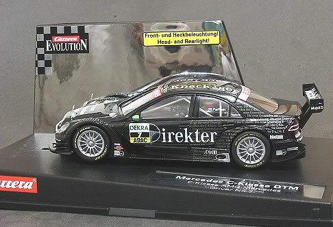

This model is finished in the “Direkter/Straffer.com” Livery, (both of which take you to the International Mercedes Benz website!) a case of this years new black is…. BLACK! Still very attractive but I’m not really a ‘black’ person. (It’ll be a devil to keep clean!). As we are coming to expect, the detail and finish are first class. It is a difficult job to find any defects worth worrying about on this model. Black hides a multitude of sins and this model has very few. The three pointed star sits raked back on the front of the bonnet and all else flows on after it.

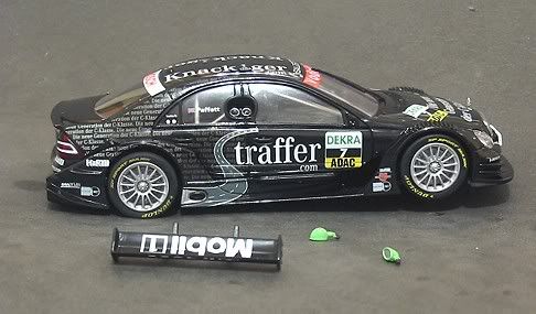

This model also has the detachable vulnerables! The rear wing and the door mirrors detach for racing to reduce the risk of breakage. I have to admit that the rear wing was quite stiff first time whereas the door mirrors virtually fell out. I like this idea if only from the point that when its racing days are over, I can pop them back in and clean it up for the display case with all bits intact. The mirrors are almost lime green which shouldn’t make them too hard to find in the bottom of your race case.
