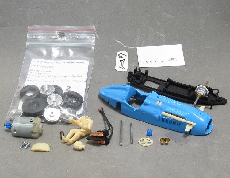

Monoplace are a ‘boutique’ slotcar maker from France; probably made on the kitchen table of a farmhouse in rural France. Nonetheless, they make a very nice model and have a select range of desirable models in their catalogue. The only problem is that they have small production runs and to my knowledge, once sold out, they have never been reissued. I will also stress several times throughout this review that care needs to be taken when handling resin parts. A bit too much pressure and it could be tears before bedtime! So, without further ado I will try and shed some light on the mysteries of resin kit assembly!
Protoslotkit.com
The first task is to paint all those bits that will need painting. The resin parts will get a coat of flat grey acrylic just to act as a primer. The resin parts will also get a careful wash in mild soapy water because they may well have release agent on them from the moulding process, and this could effect the tenure of the paints causing them to chip easily along the way. The steering wheel is a great wheel but again a bit fragile so this will have as little handling as possible. The driver can either have his head fixed to its body before painting or after. I will be doing it before so there are no seams or joins to be made good after fixing.

Moving across to the chassis, the gear is pulled off the motor and the motor is pressed into its mount. Once in, the distance for the prop (tail, drive) shaft can be measured . ( I made it 27.93 m.m.) The tail shaft wants to be a mil or so shorter so it doesn’t bind. The shaft that comes with the kit is about 37.0 m.m. long so it will need to be measured and cut down The cut end will need to be fettled to aid its fit in the spring drive. The drive shaft spring is 12.0 m.m. long and we want the drive spring to go a little short of half way down, so lightly etch a mark on the shaft at about 6.0 mil. from the end and holding the shaft in a pair of small pointed pliers, twist the spring on by hand until it is just short of the mark. Finally fit the shaft bearing and the pinion and this should then be ready to go. Pop in the guide and after a quick trim of the guide leads the chassis is as good as done!
Meanwhile, back at the body there is still work to be done. All the add-ons are made of resin. Some come in place in the model and need to be painted. When removing or handling resin parts always take care!. They are not as strong as plastic and will snap with the least effort. So, carefully remove any resin parts that might be in place. they will now need to be fettled so that the flash and other imperfections can be removed. On this model, with the exception of the driver, all the resin parts are going to be silver.
The parts were tidied up and mounted in small alligator clips. I have found these clips to be the best way of holding parts while you spray them and mounting parts when you want to leave them to dry. The first coat of paint was flat grey primer. This gives a better bonding surface for the silver and should ensure a bit of longevity for the paint job. Once dry I then sprayed the parts with ‘Bright Chrome’ from Repco’s auto stores. This is the best silver you will get as most other brush on silvers come across as metallic grey, but this is a real shiner.
One other thing to do at this stage is to get the chassis to slip smoothly into the body. You don’t want to be doing this when it has been painted or lacquered or anything else. The rear spring hangers don’t slide comfortably into the body, so the body slots have to be opened up. This can be done easily with a flat modellers file. The chassis comes as a black finish and at first I thought it might be black plastic of a kind, but while I was painting the rear springs which are part of the chassis, I noticed there was a spot were the paint hadn’t covered and the chassis reveals itself to be resin also. No big deal but just handle it with a bit more care than you might. Also, the body mounting posts are moulded in resin as part of the body, so we won’t be putting the screws in with too much effort! Tapping out the screw threads should also be done at this stage. But before that I reinforced the posts.
I filed a small flat on the pointed end of one of the screws. This behave a bit like a thread tap and gave the removed resin somewhere to go. If we were to screw the screws straight in, I could almost guarantee the posts would split. Next up I glued a short brass tube over both mounts. This also minimised the risk of the posts splitting. Once set, the filed screw was turned into the post half a turn and backed off a third. I continued to do this until the screws were three quarters into the post. After this the body was mounted on one of my ‘lolly stick’ jigs. With this I can handle and move the body about without disturbing decals or fresh paint.

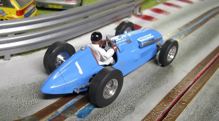

So there we have it, A very nice model and almost too good to go on the track. But a track test has to be done and off to the track we went. A short and technical four lane board track with copper tape awaited me and as it was a race day I decided to get some miles in after racing. This would ensure the track was in tip top condition and grip would be at a maximum. Remember, this is a resin body model with a front motor. In the past (Ref: Maserati 250F) I have added ballast to the back of models to counterbalance the weight at the front. In this case I won’t be bothering as firstly, it isn’t my model, and secondly it may well never end up doing serious competition so it would be nice to keep it original.
Once on the track, the first and only disappointment was that the model just wanted to snow plough and the back kept swinging out. The problem was soon spotted. When on the track the front axle moved up slightly causing both front hubs to touch the suspension detail and making the front end drag. I got the model moving and rather than disassembling it and filing stuff, I ran the model with the axle dragging. As expected, the hubs slowly wore away the offending resin and within a couple of dozen laps the model was flying. The tyre grip was excellent and there was very little tail sliding or indication that this was a front motor model! Tyre rubber is good for painted tracks and apart from a little sanding, they should be fine for most occasions. The front tyres come with a concave tread face. I would leave them like this as it will present a minimal amount of friction in the corners, where you don’t want it!
This model has been a challenge because of some of the fine tolerances with resin parts. Getting the front suspension detail in is an art in itself. Also, wangling the rear of the chassis into place around the exhaust is also a potential source of consternation! But eventually it was all together and running. I give this model 9½ out of 10. Most of it based on subject matter, the rest on the accuracy and finish of the resin parts and decals. Yes, no doubt the Cartrix model, when it comes out, will possibly be a more accurate scale model, but this one will have detail the Cartrix may well not!
The model comes in three stages of assembly. Complete knock down kit with no painted parts, CKD kit with painted body, and an assembled model, all priced accordingly! The only remaining concern is the long exhaust pipe. The left hand back wheel will need to be removed every time the chassis needs to come out, so it is going to be essential that this model goes together well; then chassis removing will be kept to a minimum.
This is another great classic slotcar which has the added benefits of the weight and downforce of a resin body. The model drives well and although I suspect the front and rear track are a little wide for true scale, I would leave them where they are. This will generate some handy extra stability!! All we need now is some peers to race it against. I’m sure that between Monoplace and Cartrix, they won’t be too long in coming!
