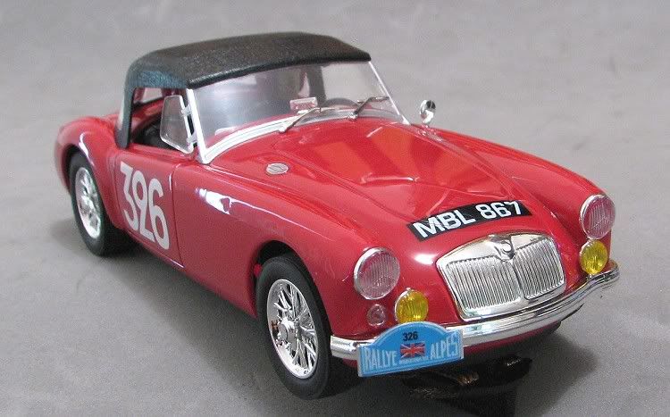

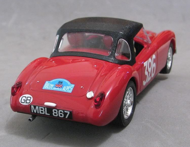

As mentioned before, the body is very smart. A nice not too bright red finish and a very deep gloss lacquer coat. The little tampo there is , is also first class. From the side numbers and rego plates to the Rally plates, and even the little chrome screws on the boot lid which cover where the boot rack would have went on the real car. SCX have even supplied a cute exhaust tail pipe in hollow section just for realism!!

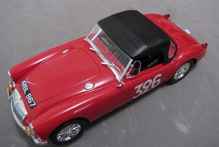

Front and rear light detail is excellent too, and when running there is the usual show of light which only SCX can do. There is a little light bleed around the headlights though but not instantly recognisable. Screen wipers, wing mirror and rear view mirror all add to the realism of the model, even though I suspect the wing mirror could be an early fatality, and the roof adds to this image. Mmmmm? But just a minute! The car driven by Nancy and Pat was a hard top?? No doubt about that. It was a hard top sure enough, with sliding side windows. This model definitely doesn’t depict a hard top?? The worst bit is that it probably has one of the best, most realistic soft tops I have seen on a slotcar!!
Moving on in wonderment I notice that like a lot of SCX rally models, the Smothers Brothers are in control of this model, but hey! Shouldn’t it be the Smothers Sisters!! No matter, perhaps that is asking too much. But detail inside has been skimped and there is no discernable dash detail and both driver and navigator are wearing the most un-fifties rally wear! Including open face helmets and seat belts!! I think not Mr SCX!!
Finally, looking around the outside trim, the model is quite accurately modelled. Once again, the only thing that lets it down is attention to finer detail, but SCX don’t do that!!! A photo etched grill would have set the model off nicely; and as previously mentioned some nice wheels wouldn’t have gone astray, and a nice set of scale ‘Michelin X’ tyres would have completed it for me, but it wasn’t to be!
