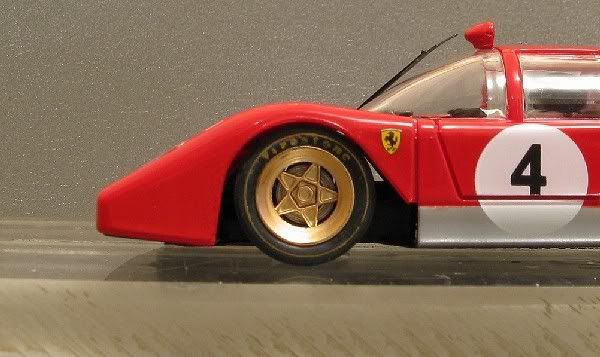

So what do we have to start with, well, surprisingly, not a bad package actually! The model I think was Spirit’s first (I am prepared to be corrected there) and the moulding is a bit bulky but an accurate rendition of the 1/1. A very bright red as you would expect and as a copy of the 512M it came minus a tail which meets one of the first requirements. The paint job and the clear coat are very good too; another surprise! The silver tampo to the lower sides does run out early before the bottom of the sill though. The transport screw has been over tightened and while in storage the base has contorted a little but it hasn’t influenced the position of the axles or guide which is good.

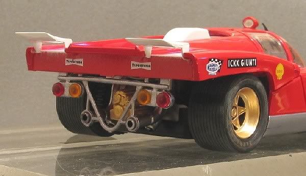

Exterior bits are a bit ‘clunky’. By that I mean they look a bit bulky and the painting and assembly sees sprue flash where it needn’t be but this car is for the track and at some time in the distant future it may well adorn the back row of the display cabinet. Things like the rear aerofoils look a bit ambitious and the poor windshield wiper makes absolutely no attempt to follow the contour of the screen! No worries, it is still an eye pleaser in its minimal decal finish and gold Ferrari five spoked wheels. To follow up there is a transmission and rear end detail which is moulded in several parts and in spite of the minimalism of the rest of the model this part, complete with lenses and dampers, must represent fifty percent of assembly time for the model!

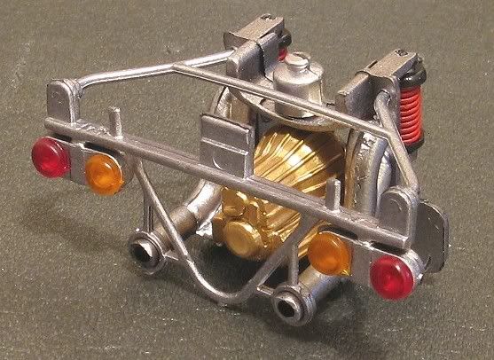

Next up is a look inside and the three screws were removed. I am not joking when I say these screws must be thirteen or fourteen millimetres long. Indeed, I wondered what else they must be holding on but just the chassis is the fact. So, screws out the top comes off. First to fall out is the rear end detail. This sits in a recess in the rear chassis and the top has to be guided into some mounts when the body goes on. Next to fall out were the headlight lenses and recesses. The heat welds had been overdone and the chassis had been the only thing keeping the lights in the model!!. No matter, these have since been glued in. Not the end of the world, yet!

From a chassis point the traction magnet is fairly strong but the model stands high on its wheels and must be 0.5 to 0.7 mm higher than say a Fly model. This will let it down on some of the lower down force tracks like Carrera and I suspect It will struggle to match other makes even on Scaley and SCX tracks. The wheels are finished in a very nice gold colour but again it would have been nice if they had had a coat of clear just to make them shine a bit. Lastly Spirit have attempted to replicate the Firestone tyres complete with gold printing but the tyres are a poor moulding and the gold is a bit messy trying to highlight the uneven writing.

Just looking at some of the photos and a question about the shaft of the motor hitting the rear wheels......
With the MJK FLY Classics on, wouldn't you have to sand a lot off or would you have to possibly cut the Motor shaft?????

The original tyres are deceptively large. The new tyres went straight on with half a mil to spare. No sanding or anything!! I suspect maybe Spirit use a slightly bigger pitch spur and pinion than Fly giving it a bit more space?
