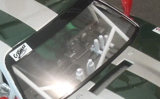

Moving on and in, the interior is another Scalextric masterpiece. Full dash detail front AND rear. A full competition roll cage and detailed fuel tank in the rear. The driver too is looking relaxed in his little space and his helmet is one of the better modelled aspects. Just above the drivers window is what looks to be a lifting hook. I can only assume this is for the cranes to lift the car off the track in the event of a no brainer! Still, a very nice touch with a possible limited life.
