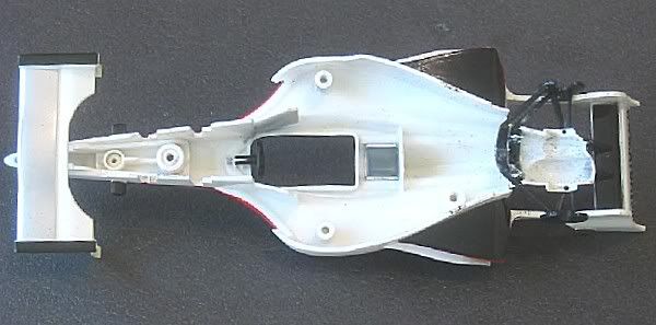

The A1 GP ‘Switzerland’ is a very ‘pretty’ car. The silver and white livery with the red of the Swiss flag is easy on the eye and easy to pick out in a bunch. The body shape designed by Lola International flows too and there aren’t a myriad of vents, foils and miniwings spread all over awaiting detachment! Just pure simplicity and, with the absence of a swag of sponsor decals, really nice. I was looking forward to running this model but firstly, a look inside to see what the business was and to check on any potential problems, I needn’t have bothered though as this model is uncomplicated and functional. The only defect visible was, even at this early stage, the yellowing discolouration of the body parts around and alongside the rear wheels?? I thought this was fixed twenty years ago?
Four screws hold the chassis in place and once removed the model separates easily at the tub seam. The nylon front suspension and fixed front axle sit firmly in place on the front chassis section with the front fixing screw holding all in place. The guide is the standard Scaley round guide with quick change braid plate and again there is minimal slop in this. The ‘F’ can is well mounted and has a sliver of what looks to be a masking tape type material on its underside. No doubt this contributes to removing any mounting slack that may occur in the variances of manufacture. A long output shaft on the motor allows for a very usefully sized neodymium magnet to be mounted between motor and rear axle and finally the rear axle has sturdy mountings to the chassis. There is a little bit of slop in the rear axle bushes but no more than the vast majority of models now available.
Wheels are true and tyres fit well. On this model, the rear tyres were a bit reminiscent of the ‘90’s Scalextric tyres as far as shape was concerned and they took a bit of sanding before they were concentric? Underneath the chassis is basic and problem free. The modellers have simulated the ‘plank’ structure under the car and as described later, this did present a couple of problems. I didn’t need to make any repairs or modes to the inside of this model. I didn’t even glue the motor in, that’s how confident I was with what I saw.
