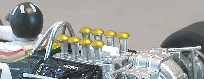

Detail like the chrome dome nuts which hold the cylinder heads down on the real car, plug leads as part of the cam cover moulding, finely sculptured exhaust extractors, rear sprung dampers and excellent suspension detail front and rear. More obvious are the eight white bars of the Henley Rowing Club on the crash helmet, one of Graham Hills favourite institutions, and something that son Damon also used. Cockpit detail is as good as the best and one point that to me makes this model more accurate than the Tasman model, is the complete livery detail. Due to anti tobacco legislation, the highly collectable limited edition Gold Leaf model is void of the huge gold sponsors graphics on either side of the model. The final touch is, yes you guessed, the wheels and tyres. Ultra fine detailed tyres front and rear finish the model well.
A twist in the tail!
But, there are some brick bats amongst the bouquets!! Apart from the inherent weakness of axle mounts as we have discussed, there is the almost casual carelessness of the application of some detail. Most noticeable are the air intake ram tubes. These are decidedly out of align and where I was looking for two almost militarily precise rows of trumpets, I got one almost square and the other more than crooked. I did look at the fixing when I had the body apart, but one false slip could see the unit become decidedly second hand!!.

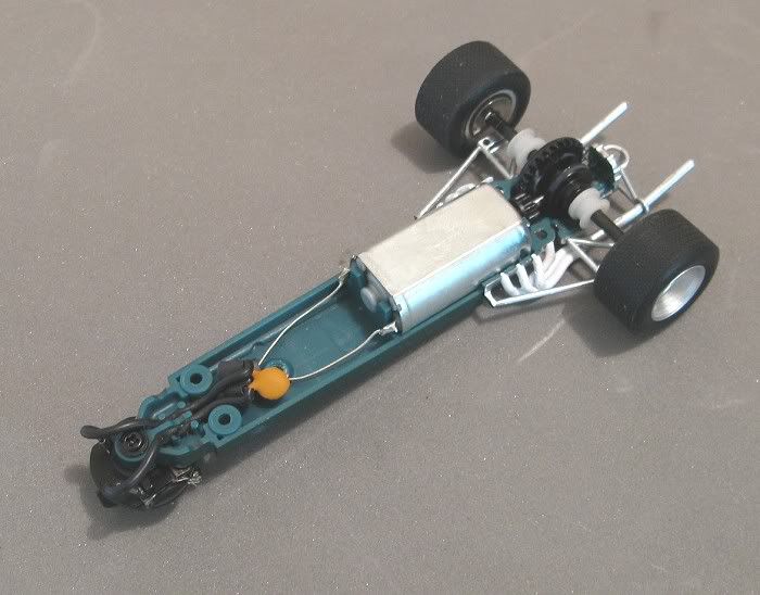

So from the outside the model has that ‘come on!’ appeal. What about the inside?? As expected, the inside is filled to the max with functional parts. The motor, contrate, RI components and front suspension are pretty much occupying the vacant space. The unseen parts of the driver take up what’s left, so, unless you take something out, you’re not going to get anything else in, like ballast! But for the magnet racers all is fine. The model weighs in at an amazing 48 grams and combined with the FF motor this is guaranteed to be another pocket rocket from Scalextric.
On plastic it is unshakeable. The button magnet has little work to do and it is only the fact that it has treaded tyres on the rear makes it just a little bit nervous in some corners. Straight line acceleration is blisteringly quick for a motor rated at 18,000 rpm and disaster too is blisteringly quick. No matter, this is truly a model for the SCM on plastic but what about the needs of the more talented board track racer?? Mmmmmmm? At 48 grams and with the current motor I suggest that unless the model is disfigured with unsightly external weights or savaged internally to accommodate a little more ballast then the best, (and my preferred) option is to turn down the power!! These models come rated for 12.0 volts and are inevitably run on uprated power supplies at 14.0 volts and more when what we should be doing is turning the power down!! Knock it back to 10.0 volts or less. They drive magnificently at this and are far more predictable, and if you have an F1 class for these, with everybody running at the same voltage what’s the big deal. I call it the NC1 syndrome. Some of the closest and most exciting slotcar racing can be achieved with slower models.

I just purchased one at a very good price and it has exactly the same ram tube offset, as well as the tail pipe height angle. Did you put yours on Ebay and I bought it? lol The carb intake offset really bothers me, like a sore thumb. I have looked at disassembling mine twice but backed off, the dam thing is so small and delicate. I surmised that the plates beneath the ram tubes might be pinned and you photos proved me correct. Without your expertise I might have tried to pry off a pinned piece. If you get the chance, please explain just how you managed to get this model apart !! It is a tight delicate fit. ( no inneundo you wankers).. seriously need some guidance. Peter Shannon has done his homework ! Many of the 66/67 Loti had RayBan windscreens, some of them double layer, with "air" intakes. All in all a great model for a slot. Just got to get rid of that sore thumb....

Its a long while now since I had it apart, but I have raced it successfully in more recent times on a painted magnabraid track where it worked quite well on MJK urethanes. One plus though is that one sided exhaust was knocked off in one of the heats and when I reglued it I put it back on straight!! Can't see me knocking the ram tubes off though!
