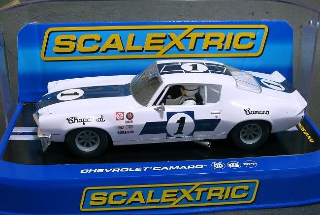

The subject matter nor the driver, I’m sure need much introduction. The Chevrolet Camaro is one of the icon muscle cars from the early seventies and this model is a much awaited rendition of the Jim Hall ‘Chaparral Racing’ car. Once again, unless you’ve been living on a desert island, Jim Hall too will strike a note in most over forties’ memories. The man who took on the might of the factory teams in the Can Am series and using then revolutionary techniques to suppress the opposition. How much we owe to Jim regarding aerodynamics is immeasurable but I suspect there is more than a significant percentage.
The Trans Am series though wasn’t about ground effects and technology. It was about set up and more importantly, driver ability, and although there are one or two names from Classic Trans Am that come to mind before Jim’s , he was there doing it as always and in doing so, gave other competitors a reason to lift their game.
This model from Scalextric is another great RTR slotcar. Out of the box it is well balanced and tenacious from the word go and there isn’t much to do to get the model competitive. I would even go so far as to say that it is a match for the ‘up ‘til now’ dominant Mustangs. There, I’ve said it. I suppose I’ll have to back that statement up one day!! But I am confident.

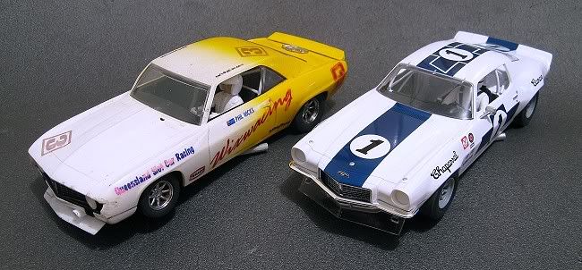

This model was bought by me as a replacement for the Scaley ’69 Camaro I have campaigned for more than several years now. That model started life at breakneck speed on the old Mt Perrorama Super speedway. Almost new and its first serious competition, the model drove flat out into a racing incident under the monitor, where upon the entire driver’s tray broke loose and the chassis deformed, dragging the side pipes along the track.
With the front of the model being well smashed and fighting back the tears I put the model back in the race box and down the track I bought the Hornby kit body. This I reliveried in Wixwacing yellow and white. The model was then campaigned hard for several seasons until finally it couldn’t hold its own on plastic tracks. The motor well passed its use by date and the model battle scarred and worn in general, it was placed in the Classic Muscle class at the Eggdome a few weeks back. With fate on my side and possibly a guardian angel or two watching over it, I managed to win the race overall. Many thanks also to the marshalls that night to who it must be said, helped me immeasurably too!

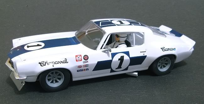

So the fried egg has retired and now it’s up to Jim Hall to bring the laurels back home. But having said it’s more than good SOOB, what is it really like. The model is first class and as we expect not only from Scaley but all mainstream manufacturers these days it is well turned out tampo wise. The paint jobs get better and better and small details like the bonnet and door clips are not only painted but moulded into the detail. The text of the SCCA badge is readily and clearly defined even if I did have two pairs of specs on to read it.
At the front is a beautifully etched metal grille and the bonnet (hood) badge clearly reads ‘Chaparral’! the front and rear bumpers look a bit vulnerable and I promise not to cry when they eventually, sooner or late, get lost in the fray. A novelty to me is a rendition of an acrylic air dam to the lower front. I can’t dispute this isn’t a faithful reproduction as I cannot imagine Scalextric making anything but the proper job!.

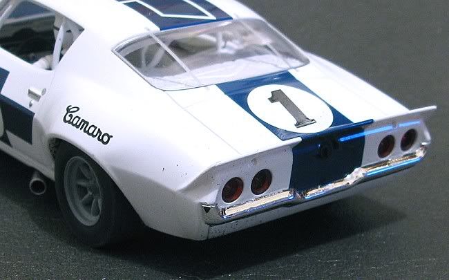

A full roll cage to protect Jim and a good Jim too! This has to rank among the best Scalextric driver figures to date and just outside his window is a good flexible door mirror. This, I’m sure, will far outlive the bumpers! At the back of the model are round tail lights which are a feature of this era. The body ends in a very nice ‘duck tail’ spoiler and a rear bumper which might well outlast the front one. Wheels and tyres are very similar to the earlier Camaro but I suspect the front tyres are actually bigger. Being almost if not as big as the rears.

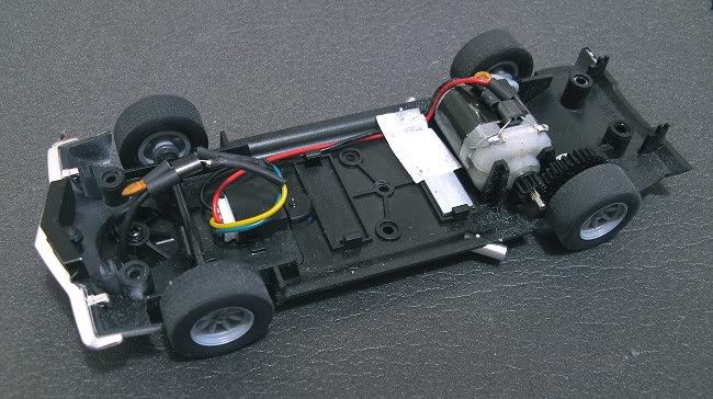

There is very little similarity between this model and the previous one. The chassis is a ‘Digital Plug Ready’ chassis and internally differs from the early model. Dimensions are different and the shape varies too. When removing the body it is necessary to be careful at the rear. Remove the front and rear screw and the two countersunk drivers tray screws before attempting to remove the chassis. Pull it out from the front and when at about a third open, waggle the chassis carefully from side to side and the rear of the chassis, which dovetails into the body, will work its way out. Any attempt to pull it directly will result in damage to the rear valance and the bumper. Putting it back is another story too!
Once inside the usual items are ready for attention. The motor is tight and the traction magnet is firmly in place and quite strong too. Unlike the earlier Camaro there is only one other magnet position. Again, the front axle is solidly mounted and strengthening webbings and mounting posts restrict the opportunity to put ballast in the more useful spots. The new guide fits deep into the slot on my test block unlike the early model which had to be shimmed down a good amount to get a good depth. Interesting to note too that there are extra reinforcing webs inside the chassis especially around the motor mounts. Not being aware that these models had a chassis problem, unlike the V8’s, it bodes well that Scaley are keeping vigilant when it comes to weak spots in their models. The track and wheelbase are comparable with the ’69 model and dimensions in general are similar but what is it like on the track Mmmmmm? Let’s find out!

The only essential mods in my view are firstly, to choose the tyres to suite your track, and secondly, to get the body to float a little with loose screws, scrape or file around the rear valance 'dovetail'. This will allow the body to move more at the rear and will also ease chassis removal and installation. So, hopefully, more a story of same old same old, but time will tell. With the old ‘fried egg’ ensconced in a prominent position in the display cabinet, this model has a huge reputation to uphold, and do you know, I think it just might!
Re: Scalextric Camaro 1970 'Jim Hall'
In spite of being a great livery, on the track this model proved to be a bit of a disappointment! The issue was the traction magnet. When Scaley designed this model, for some unknown reason they decided to mount the magnet noticeably higher than the early Camaros. One solution was to sand the tyres down, but by the time there was enough grip generated, the spur gear was dragging along the track and top end was lost!!.
The model does now go well. I have Dremelled the magnet position until it is a little deeper and combined with loose body screws, I have managed to get a contour on the chassis which presents the magnet a bit better in relation to the conductor rails. The model has always gone well on board and indeed has been a winner more than once in the past, but now it can hold it's own against the Scaley Mustangs! An achievement indeed!!
