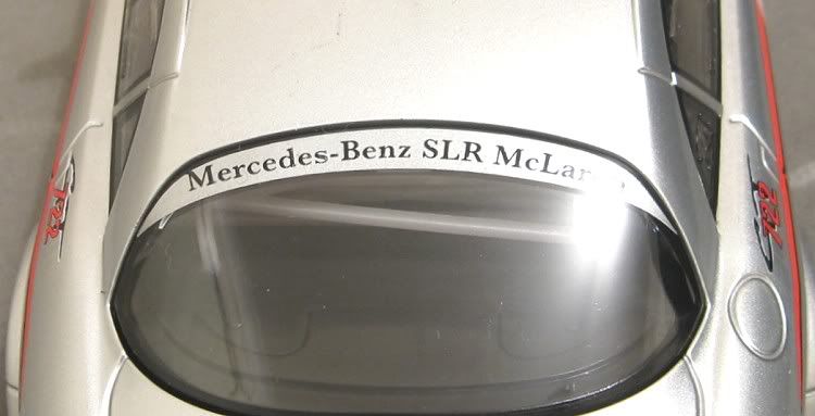

All that aside this model is still available as an RTR and a nice model out of the box it is. Looking round it is a delight and the Tampo is excellent and almost possible to fault. It has good lights on it front and rear and the finer detail is clear. Some nice shiny discs behind the wheels and a nice set of wheels and tyre.

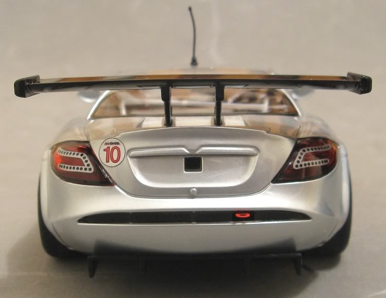

Once again we get flexible door mirrors to minimise racing statistics and a nice detail is the roof aerial although this isn’t detachable like some seem to be doing now. The rear wing looks a bit vulnerable now but it shouldn’t take much to remove it before racing. Once the body is off the chassis the rear wing looks to be held in with a couple of spots of glue.

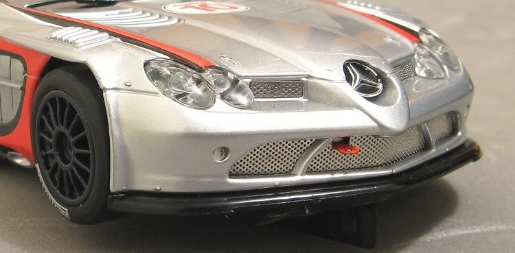

To me the nice touches are the photo etched front grille and the lights, especially the rear lights were Mr Scaley has finely crafted the clear parts that are part of the real thing. The wiper arms are very convincing too. The only criticism of the finish would be that the red side flashes don’t go round into the front wheel arches, leaving a rough silver strip in clear view behind the front wheels, and on that note its time to take the body off.

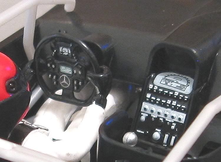

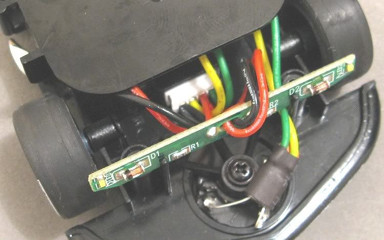

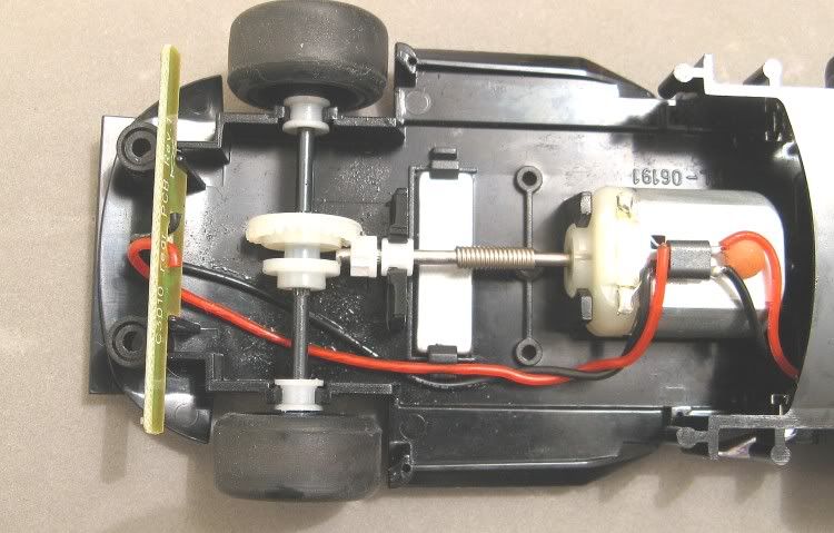

Four usual screws and a couple of little ones into the drivers tray need to be removed before you stand any chance of coaxing the body off, and even with these removed it is still a little bit of a struggle. Take care not to damage the front or rear light boards inside as the body needs to be ‘wangled’ around them. Once inside, the driver’s tray can be removed and yes, another classic drivers tray it is. The car should really be a soft top or similar as it’s a waste of a good interior to have it in a hard top. Most of the detail is present with a well detailed centre console and steering wheel. The driver looks at home with his lot and I’m sure Mr Scalextric is proud of his work!

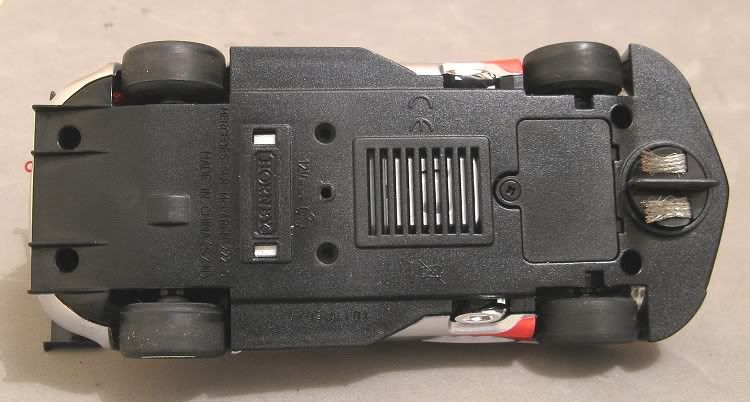

Getting back to the chassis we have a very tidy layout once again from Mr Scaley with a mid mounted motor and prop shaft assembly. If you are a non magnet or board track racer I will point out that in this model the motor is a little loose in its cradle and that may translate into juddering and hopping under load, so that will need attention, but there’s plenty of room for whatever fix you choose. The chassis has a cover over it towards the front end and the only reason I can see is that it is there to add some background to the lifelike louvers on the bonnet, guards and side.
This model has the old Fly style front stub axles, I am assuming to make more space for the digital chip to fit as they are not in line with the guide. But if you are running analogue and you don’t like this setup, there is plenty of space to fit a solid axle, or even a ‘Wixle’ to retain independent front wheel rotation.
A plus is that they are a little loose but are nothing like the good old fly stubs of yesteryear. Also, the rear axle bushes are slightly loose in the chassis so that’s another thing that will need attention for ‘sans’ magnet events, but we should be used to all this by now ,and the fixes take only minutes. The prop shaft too could do with a spot of superglue on it’s bearing ‘just in case’.
As always, while you have the top off, it doesn’t hurt to go round the model with an oiler and a greaser and I am sure the model could do with it. The traction magnet is quite strong but not over powering and is located in a good spot for the model. With little else inside it is fair to say that Scaley have got the hang of putting these models together and there is nothing that is going to frighten us in the middle of a race. One last observation I would make is to be careful refitting the body to the chassis. The two light boards are not fixed in place and seeing as it was tricky getting the body off, trust me when I say it can be tricky getting it back on. Make sure the body mounting posts clear the light boards on the way back in.
