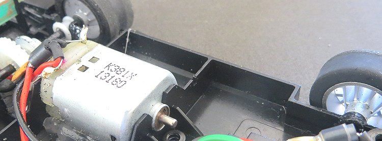

After extolling the virtues of an inline set up, it appears the motor is loose in the chassis!. The simplest solution is to carefully hot glue the motor in place. With the top off the bare essentials are visible and again there are some good ideas (and some not so good) on view.
Starting at the front, the guide is a poor sloppy fit, its only saving grace is that it is a deep guide at 7.0 m.m. deep. This will preclude it from being raced on old Scaley ‘Plexitrack’ or early SCX track as their slots are barely 5.0 m.m. deep. Also, having a fixed front axle precludes it from being run on tight banked corners; chassis improvements include raising the height of the bracing ‘ribs’ for want of a better term. These prevent the chassis distorting , even with the screws loosed off. The motor and axle bracing is only 1.0 m.m. thick so I would keep motor and axle removal to a minimum wherever possible. Too much activity will see thes items crack and possibly break quite readily.
