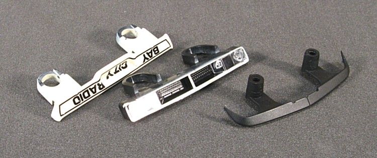

The model has lights front and rear, and the front light assembly has been moulded well. On closer inspection the car’s acrylic headlamp protectors have been modeled too which is a nice touch. But they did cut the corners with the flasher lenses at the front, and all we get there is a bit of orange paint on the body!Also like previous models, the model is clipped together with almost no sign of the heat welds that almost all other manufacturers use.

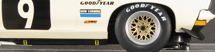

Visible inside are the usual delights but Scaley have backed away from a detailed dash and interior with almost everything, including the roll cage finished in black. Wheels and tyres are attractive but both are going to be an issue. The wheels are almost all eccentric and also have a little wobble when they turn; and where they were attached to the sprue during moulding there is a little nib protruding which must affect the tyre seating. To add to that, once fitted, all tyres seem to be very concave on the wheels. To me it looks a little like the rim outer diameters are either too big or the centre diameter is too small.
On measuring the rims there is a discrepancy between the inner and outer diameters with the inside being 12.79 m.m. and the outside being 13.13 m.m.? This would account for why the tyres seem to be larger on the outside edges and why there is the necessity to sand off a lot of rubber before the tread area is flat. Either way, if you intend to race this model you will need to do some serious work on the wheels and tyres to get them true.

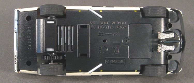

The model out of the box came with the traction magnet in the rear axle position. Again not a big deal but for most magnet situations it would be best suited in the position in front of the motor. Axles are also as we are used to and the font has a little slop up and down whereas the rear is reasonably tight. The motor too is very tight and there will be no need to fret over it working loose at any time soon. And the gearing is the old faithful!
But!.... Scaley have decided to bowl a googly with this model..?? Will it affect its handling and drivability? The jury may be out for a long time on that one! So what’s the problem I hear you say..... well.....
Scaley have faltered a bit with the power train. The motor is most definitely off set to one side, and given the space available in this huge model it didn’t, in my view, need to be. Big deal? perhaps not, I’ve seen worse in other models. But not only is the motor to one side, Scaley supply the model with the magnet in the rear position, also not a big deal as there is a forward location for the magnet. But this is also offset the same amount to the right hand side of the model??
So what is the reality, probably very little. The magnet in the rear position is a little less helpful on home and small club circuits and the optimum for the average track would be the spot in front of the motor. But, on removing the motor and rear axle and prying free the magnet, it soon becomes obvious that something is wrong.
It looks like Mr Scaley has moulded the front magnet position too large, and in doing so, if you fit the thin magnet in the front position, at the slightest provocation it will slip out of the loose mounts and stick itself to the side of the motor time and again. The magnet need to be glued into position if you need it up front. Again not a big deal but I can see that the rear position has been chosen for ease and permanence during factory assembly.
The only other quandary is why the rear axle is offset? Once again I would suggest that the rear axle is a millimetre or so too short, and as the right hand wheel is hard up against the axle bush the left finds itself inboard by that millimetre or so. I’m sure the purist will be able to fabricate a new axle in very little time. As for the offset motor, I’m sure very few if any will find it a problem.

I took the Falcon to the LCR last night and set about doing some immediate updates and repairs. The first job was to remove the rear axle and true the tyres on the tyre truer. There was a fair amount of rubber came off the tyres and it came off quite easily? The tyre dust was also quite pale (i.e. not black) which leads me to suspect that there is a degree of synthetic material in the compound.
The tyres are very soft and gave no trouble hooking up on the Ferrador surface of the LCR, but I also noticed during testing that the model slowed noticeably in corners and after a few exploratory laps I removed the front tyres. Sure enough the tyres were dragging quite heavily requiring extra throttle to overcome it. I put the front axle in the tyre truer and after truing the tyres I took the opportunity of putting several grooves in the tread area. On returning to the track the front end drag had been reduced considerably; but for competition the front tyres will need a more permanent fix. Maybe the 'Wixle' independent front end and some harder front tyres?
The magnet was moved from the axle position and placed and glued in the forward position. All in all it made considerable improvement in the way the model behaved but for the average club and home racer it is still going to need the thicker 2.6 m.m. magnet before it can compete with things like the Trans Am's, Toranas and Aus.V8s
I have to admit that I couldn't detect any side effects of the lop sided chassis with the magnet in the forward position and it would be my advice not to worry about it too much; the only other mod I would carry out is to fit a wider rear axle, this will get the rear wheels further out under the arches.
