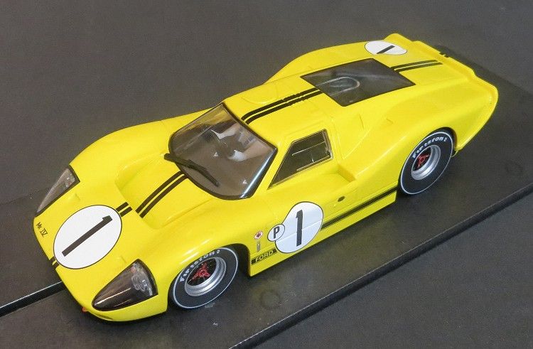

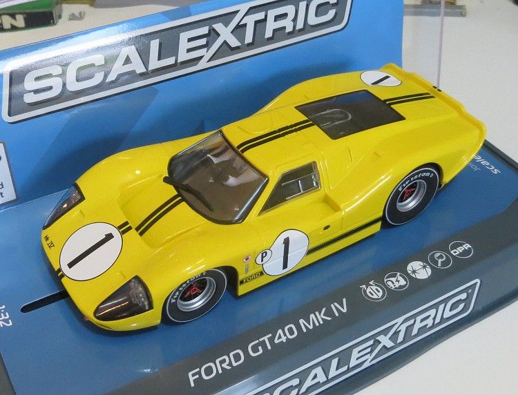

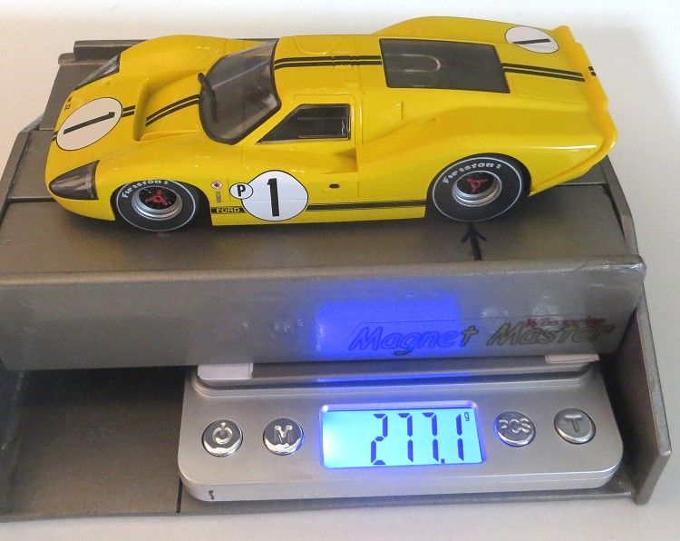

Scalextric’s choice of car looks to be the 1967 J4 car which won that year’s Sebring 12 hour; as driven by Bruce McLaren and Mario Andretti. Even with some on-line stills it is difficult to tell how good a job Scaley have made of this model., but from the outside its looking good and hopefully it won’t have too many surprises. Firstly I will apologise for my camera which has trouble with reds. The pictures posted here are more of a yellow colour because of the camera; The Scaley model in the flesh looks to be very close to the right shade of yellow.

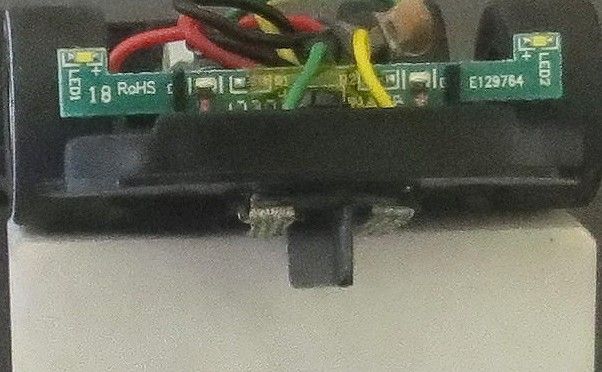

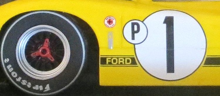

Starting from the outside we have very nice model; because the originals were factory sponsored entries there are very few other sponsors decals around it. All the better in my book! Scaley have left some exterior detail off, no doubt partly as an economy measure, and more probably, as a way of avoiding the inevitable losses, namely, the door mirrors!! Most striking from the outside are the tyres especially and the tampo on them. Lights detail front and rear is basic and rivet and pk screw detail have been omitted here too. Light detail itself inside the lens covers is good and it is an added plus that they work well too!

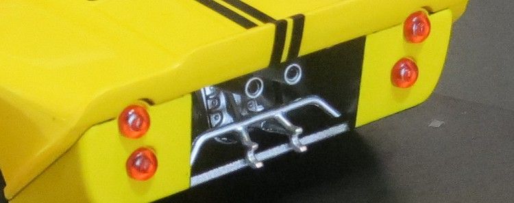

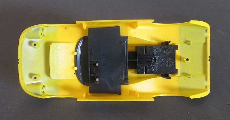

The exhaust and rear engine detail is also removable but you will need to separate the body/chassis to achieve this. Rear light detail is basic but once again works well on the track. A note here too is that the inside body detail has a masking colour around the light area, no doubt to mask the greater part of light bleed, which again, it does amply!

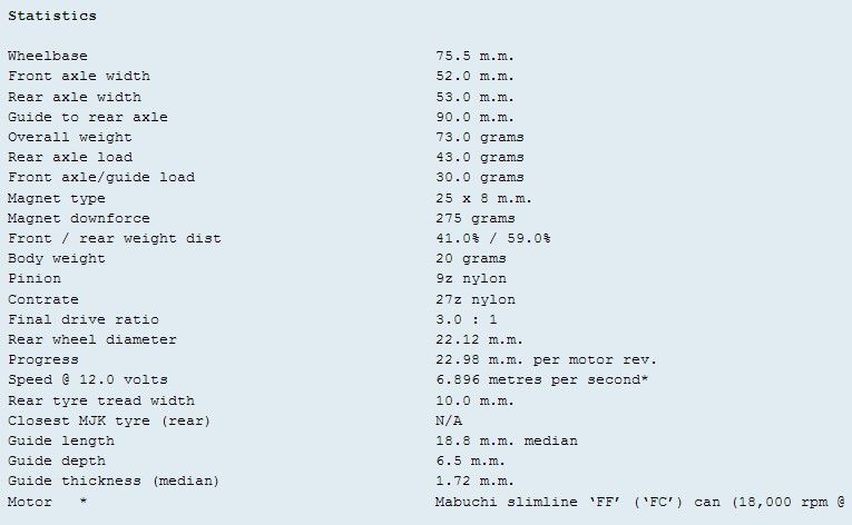

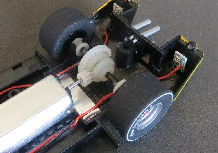

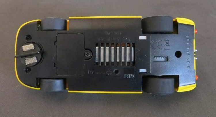

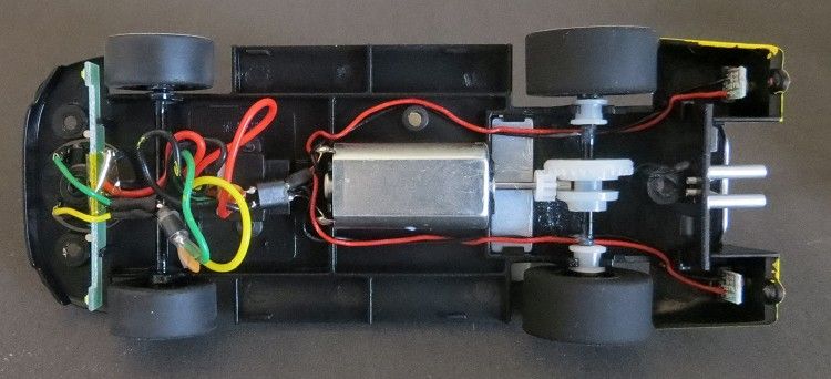

With the top off there is the new look Scaley chassis, whose virtues I have already extolled on other models. This results in a rigid but lightweight chassis quite capable of doing the job which will be asked of it on the track. The motor is well secured and should not be an issue; so are the axle mounts. An observation here is that the nylon axle bushes appear to be oval. In one position they are a snug fit in the chassis brackets, but if you rotate them a quarter of a turn they are decidedly loose and floppy. My advice is to rotate them to the tight position, then, with the tip of a hobby knife, apply a bead of superglue to the bush-to-chassis joint. Don’t apply too much as you may want to replace/remove them at some future time!
The slot in the contrate is 2.0.m.m.wide and the motor pinion shaft is 1.5 m.m.! Scaley have overcome this by fitting a fine sleeve over the end of the pinion shaft. Be warned that some of these are loose and losing one will stop you running the model. If the sleeve is loose I recommend to superglue it in place before doing any further work on the model. The FF motor has a usefully long pinion shaft which allows a decent traction magnet to be fitted between motor and contrate.
As we are finding, the new superlight Scaley bodies come at a price; one being that the body mounting posts could really be a bit thicker. Other leading manufacturers have already learned the futility of narrow body posts, some thicken them up, others might reinforce them where they are anchored to the body. Whatever happens, If you are going to race this model then to avoid tears before bedtime you will need to take similar measures.
