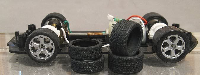

All fired up, I then went to address the final drive mismatch, yes you heard me right. So what’s up with the final drive. Well, both front and rear reductions are the same! 10 : 28 or 2.8:1. Yeehhh! So? Well, the front wheels are a little over 20 mm in diameter and the rears are a little over 21!! This gives the drive line a ‘snow plough’ problem. The rear wheels are travelling a couple of millimetres further than the fronts per motor rev! This would need to be addressed as it would cause all sorts of problems, under braking especially. Do I increase the rear ratio or reduce the front? Mmmmm? This would give me the choice of two mm per motor rev (I refer to it as ‘progress’ in the statistics). I could have reset the front and had a high progress but instead, as we race on technical circuits, I opted for a lesser progress. The rear drive ratio was reduced to 9 : 27 (3 : 1) as the rear tyres are large enough already and braking could be reduced if the progress was too high.
New rear end
So, after the maths I ended up with a front wheel (20.50 mm dia) progress of 23.0 mm per motor rev and a rear wheel (21.9 mm dia) progress of 22.94 mm per motor rev. This will give me my favourite four wheel drive scenario where the front wheels slightly overdrive the rears, helping to pull the model through corners and not juddering under hard braking. Rather than salvage the old axle I used a new axle and an SCX pro contrate plus a Slot.it pinion and the original wheels. When the model eventually retires to the shelf it will be a simple case of slotting the old axle back in and refitting the wheels and original tyres.

Next up was the proof of the pudding and suffering from withdrawal symptoms, not having raced for a couple of weeks, the Red Team convened for the first time in a little while and the Gallardo was in the box. Initial laps after warming the track up saw the model to be a little tailey; a little disconcerting but not the end of the world. After studying the underside I came to the conclusion that the MJK’s on the rear were uneven and not hooking up as best they might.
SCX type sevens and MJK ‘Fly Capri’ tyres
A short period of sanding saw the model respond by super zippy off the line performance and an annoying tendency to lift up on two outside wheels in a hard corner Mmmmmmm? The outside edge of both the front and rear tyres were sanded and of we set again. Still a tendency to tip and what’s more, an unreasonably long stopping distance. A bit like some of Carrera’s early offerings.
The degripping grooves. Maybe one or two less is needed?
No matter. Once home I carried out some mods to the boots. I ran them up on a tyre truing jig and cut four grooves in the outer edge of the front and rear tyres and rounded the outer tyre shoulders a bit more! This hopefully would introduce an area of lesser grip when the model started to transfer its weight in the corners, reducing, if not eliminating the tipping tendency.
