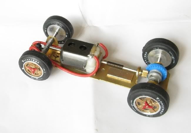

First job on the chassis proper is to pop up all the tags that will be holding the essentials, axle and motor mounts. The chassis looks to be etched too and the paleness of the brass tells me it could be softer than expected. This would be to aid bending of the tabs. Too hard a metal would see this thin metal fracture internally or with use. I do this with some square ended pliers. Firmly gripping the tab just behind the line, I bend it cleanly and in one action to as near 90 degrees as possible.
The angle can be checked with the butt end of a small steel rule. Be careful not to bend the tab backwards and forwards trying to achieve 90 as this also can induce stress fractures inside the metal. A couple of adjustments at the most should be enough!! CAUTION. DO NOT BEND the tab in the wrong direction, attempting to rectify this may well see it snap off altogether!!
Next up will be the tab which carries the prop shaft at the rear. Remember, this is a front engined model. Once the tab has been levered up enough with the blade of a modellers knife, grip it with the pliers and move it in one go to its correct position, bending only again for fine adjustment.
This is the opportunity to fit the chassis out but this isn’t as straight forward as might be expected so caution is the bye word when proceeding. The thing to keep mostly in mind is not to exert too much pressure on the chassis. It’s quite thin really and in a moment of aligning parts you could be at real risk of putting a curve in it which will be a disaster for parts alignment, so, off we go!
First up the motor needs to go into the rear mount, simple enough! Next, the front mount. A right angled bracket with the tiniest of screws. It is my view that the screw thread is too small for a conventional slotcar mount but I doubt this model will be sustaining full on racing impact. But, If you do intend to race this model in the cut and thrust I suggest you source a meatier screw or solder the bracket in place!.
Next up it is best to fit the propshaft and axle bearings. I thought at first of gluing them in but there isn’t enough material around them to ensure an effective bond so I decided to sweat them in. The mating surfaces where sanded with a piece of 600 wet and dry and one by one the bearings were fitted in place. I have two soldering irons to hand, A twenty five watt for small wiring and circuit work and a forty watt for this type of soldering. The hot tip was placed against each bearing in place and one by one, some five core solder was dabbed on each side of the bearing at its join with the chassis. Just enough to hold the bearing safely in place.
The propshaft needed the pinion fitting, this was done in a small vice and it was pressed on until, offering up the crownwheel, there was enough poking through to sit comfortably in the crownwheel slot. The transmission spring was twisted onto the motor shaft and next the prop shaft complete was fitted. Note here that it is detrimental to lever these springs on and off with pliers and the like and totally unnecessary! Simply grip the shaft lightly and with finger and thumb, twist the spring in the direction of the coil end and the spring coils will give enough to allow the spring to slide on smoothly. The same goes for removing the spring, twist it in a forward direction and pull off at the same time. Note here that if you have soldered the bearing in crooked or not bent the bearing bracket enough, the shaft and motor will feel tight because they are binding in the misaligned hole!
Next up is the guide and front axle. At this stage I have desoldered the lead wires from the motor for obvious reasons which I will mention later. The guide looks to be a Slot.it type and it comes with a novel fixing device. Firstly, there is a nylon collar sitting on the pin. Poke the guide through its hole and fit the second nylon washer over it. Next, there is a short spring in the kit. Slide this over the guide pin until it exerts minimal pressure on the washer. This will hold the guide comfortably in position and will minimise side and end play.
I’m still not sure that the front axle is correctly mounted but I studied the illustration until I was totally confused? But I think it could be right now. The long compression spring is supposed to sit over the front axle snugly and hold it in place! The only trouble is that it isn’t snug and it won’t hold it in place. The only solution to be had was to bend the spring in the middle.
This then allowed the axle to pass through it but still exert a good force on the axle to minimise the possibility of it moving. If that IS the correct mounting then I would either be inclined to solder the spring in place or discard it and fit a couple of aeromodeller grubscrewed collars either side as I do with my ‘Wixle’ set up! Anyhow, the axle is fitted and is fairly rigid. The front axle too is sloppy in its holes; this will no doubt translate into noise on the track
Now back to the lead wires. I hate models were lead wires pass round the inside of a model several times before connecting guide to motor, check out the Spirit BMW 2002 review, I had enough wire left over to do two more models. In this case I desoldered the wires from the motor, fitted the sleeves to the other end and pushed the sleeves into the guide holes with the little tail of lead wire making firm contact with the braid material. This creates more of a snug fit and minimises the risk of the sleeves working their way back out over time. I then positioned the lead wires round the motor and trimmed them to just past the motor brush contacts. The bared ends were tinned and with a quick manoeuvre dabbed the two together with a hot soldering iron.
The rear axle was tested in the bearings and once happy, I slid it in with the gear in place. The axle was centred and the grub screw in the crown tightened. Almost the last chassis job is to fit the wheels. The instructions say to glue these on?? Hopefully a misinterpretation? Anyhow, as there are grub screws in them I used those instead! Lastly, the motor and bearings were lubed and the contrate got a good serving of Vaseline. This has an alloy hub and I’ve already fallen foul of one dry alloy gear hub in the past! The wheels had already had their painted inserts fitted. These were superglued in place and the spinners tried for an easy fit, then also superglued to the wheel trims.

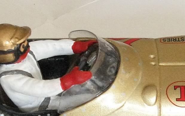

The screen on this model was scored lightly along the outside bottom edge to give it a key. I brushed a thin layer of epoxy ‘clear’ on this and on the inner edge of the cockpit and the screen was put into place with a pair of tweezers. As expected, the profile of the screen is a good, but not a great fit and there is no where to put clips to hold it in place. This can be countered by using clear epoxy. Clear epoxy takes ten minutes or so to stiffen and during this period, about every three or four minutes, you can push the screen into a snug fit with the point of a modeller’s knife. After a while it will stay in place.
The next problem to be encountered is the driver! As mentioned before he is an exact replica of the Fly open faced helmet driver and I suspect he has had a bit of trimming to fit. Even though he came in two parts, he still isn’t that good a fit, probably because I decided to assemble and paint him before installation. My first attempt saw him sitting in his seat with his right arm akimbo at the top of the screen!!?? What to do. The trouble is his bum isn’t a good fit in the seat and he needs to sit bolt upright to get his arm anywhere near the wheel! Without further ado I broke his legs at the hip, no choice. They were reglued with superglue and will be as good as ever after a repaint. Eventually the driver and wheel were placed in the model. The driver was placed on a cushion of epoxy and once in position I applied a couple of beads of epoxy to the underside of the driver in his seat and the steering shaft.
Once this was glued it was full steam ahead for the rest of the bits. The etched stainless parts were fitted and the many resin parts were glued in place. Most parts were glued from inside the model. This removed the possibility of getting glue all over the body. In the case of the exhaust and rear nurf bar the body holes were applied with epoxy using a small diameter piece of music wire. The holes were filled with resin and the part pins carefully pushed into the holes. Once again, all was left to set.

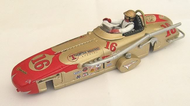

So, just about finished. The last job was ‘snagging’. This is the process of looking around the paintwork and touching in any marked or lost paint spots. Some silver bits were touched in on the glue spots and the driver had a tickle up too. A last coat of clear on the touch up parts and that is just about that! Pheeeeeew!!! And a huge sigh of relief! It is always tempting to speed up towards the end of a model and this can be disastrous. That’s why my model bench always has six or seven projects on it, I can walk away from drying decals, or paint, or glue!
So what do you get for your money? Well, firstly and most importantly, you are getting a unique (to Ostorero) model. I am not aware of anyone else making the Watson Special commercially. Next you are getting a model which will race well if you put it to the test. Super soft tyres and alloy wheels, not to mention a ‘Slot.it’ type motor and guide blade. But the reality is that apart from a few hot laps pre race meeting or at home, this model may well take centre stage on one of your shelves amongst the other models. It has been an experience to construct and in its construction there would be several things I might change purely to make it more track friendly.
Firstly, I would have made all the ‘add on’ resin parts from pewter or similar. Another low cost casting method which would enhance the models durability. I would also give the model a final clear coat over the decals to aid longevity and I would change the final drive ratio to overcome the effect of such large rear wheels. Oh, and I would do something about the small screws that Ostorero seem fond of! Not practical! And lastly I would fix the front axle setup. That’s about it! Not too much I hope. Just a track test to follow!! A gorgeous model which, in the flesh, appeals to me greatly (from someone who has been passé about oval track cars for many years!) So what are the best prices for the Lotus 38?? Mmmmmmm!
