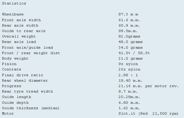

So how does this compare to the Fly model?? Mmmmmmm, Chalk and cheese well….. yes and no? In the slotcar stakes, both are very good slotcars. The Fly is a well balanced model straight from the box and both are ‘in line’ models. They both weigh in about the same and the split is very equal too. On the track the Fly model can haul some pretty quick times straight out of the box and if you run it for a while you can clip the odd tenth off your personal best for the next ten minutes. The Sideways model, on the other hand, comes from the box in race winning trim! Just as balanced and just as drivable.
The difference to me is that the Fly comes with a torquey boxer motor which can be a handful on the more technical track whereas the Sideways Riley comes with the Slot.it red engine, Faster than the boxer but a lot less torque, and combined with the higher final drive ratio, this model is more predictable in the corners when racing on the edge. I took the opportunity to run this model on the four lane ‘Al’s Paceway’ Clontarf craftwood circuit. A technical but fast circuit requiring a lot from model AND driver.
Within laps of putting it on the track the model was lapping at 11.1’s which puts in the category of super car for this circuit. There are only a couple of classes which run faster than this on race nights!! Without anyone to push me along I ran it as fast and as safely as possible, Sure enough, it was running within a couple of tenths lap after lap. Now the Fly Riley runs this fast too, but at this speed you have a model which drives amazingly well but every now and then you get the feeling of impending doom, whereas the Sideways model was rock steady lap after lap. The tyres were hooking up well and it wasn’t going to take much to get this model into race winning form.

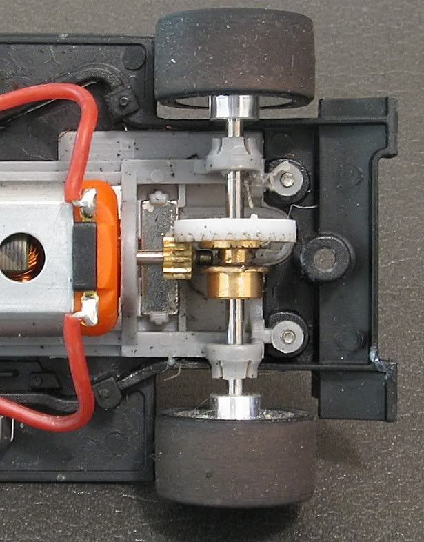

So, enough of the shiny bits, how is this model going to do the business. Quite simple really, just get Slot.it to supply the motive force. This comes in the form of a pure unadulterated Slot.it chassis and running gear. The chassis is the usual fare. A reasonably rigid chassis with a drive pod. The pod comes complete with what I can only describe as a red motor. It looks orange to me, until you put it along side an orange motor. Confused? I thought so!! So you’ll just have to trust me.
The motor pod is Slot.it, held in by four screws. These screws can also allow you to alter the chassis running height for added traction. Be warned, if you run a Slot.it controller, lowering the chassis too much will cause the magnet to short the conductor rails and in turn, quickly burn out the controller fuse!!
The rear end is a 26z contrate on a brass hub driven by a 9z pinion. Axle bearings are the ball type. These pop into the pod bearing housings which hold them firm but still allow a little bit of movement to help the bearings stay central to the axle.
There is a strong magnet which, similar to SCX, can be lowered to the track rails buy some judicious pod screw loosening. The pod and chassis is in line but the main chassis has cut outs to allow the fitting of an anglewinder set up for those that prefer it. Moving forward is a somewhat benign `H’ frame with four screws in it. I deduce this is for converting the model to the Scalextric digital system. The decoder and sensor should fit in nicely once the frame has been removed.

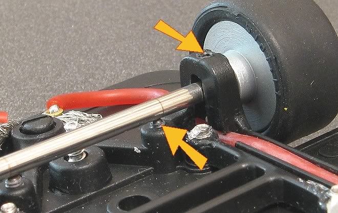

Moving further forward, the front axle is held in place in its elongated mounts by four tiny screws. Two screws come up from underneath, and two screw down from the top. This, no doubt, allows you to fine tune the front axle height depending on your preferences.
The rigid height of the front axle can be moved a mil or so on these screws or the axle can be left loose to slop around if that’s what you prefer. No doubt this function is to help set up models on different types of plastic track, as their conductor rails vary in height from track to track from make to make. You can also use this adjustment to hold the front wheels clear of the track if that is your preference!
Another observation here would be that the rear wheels are alloy fixed with grub screws whilst the fronts are push on plastics!! A word of caution though. If you have the front wheels off for any reason, be careful when refitting them as the wheels will push hard against the axle mounts if you are not careful, causing the front axle to bind. Last up is the guide. An old favourite. Quite deep enough for most tracks and with the lead wires set in channels in the chassis, you should get a reasonable self centring action. A marshalls delight!!
