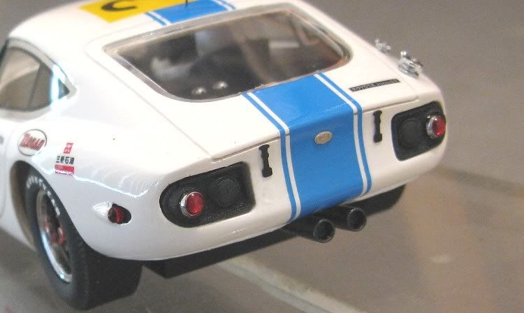

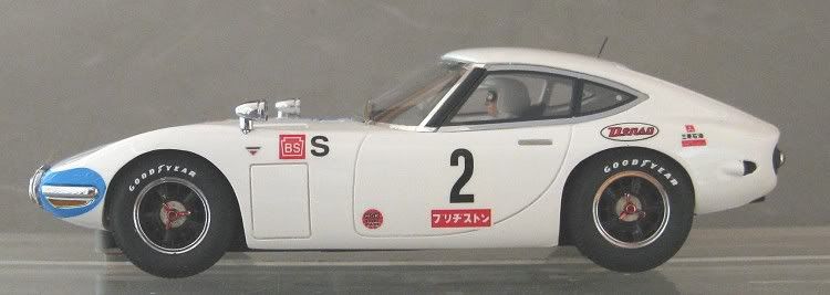

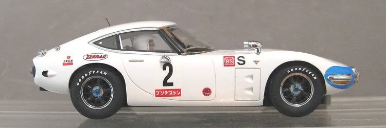

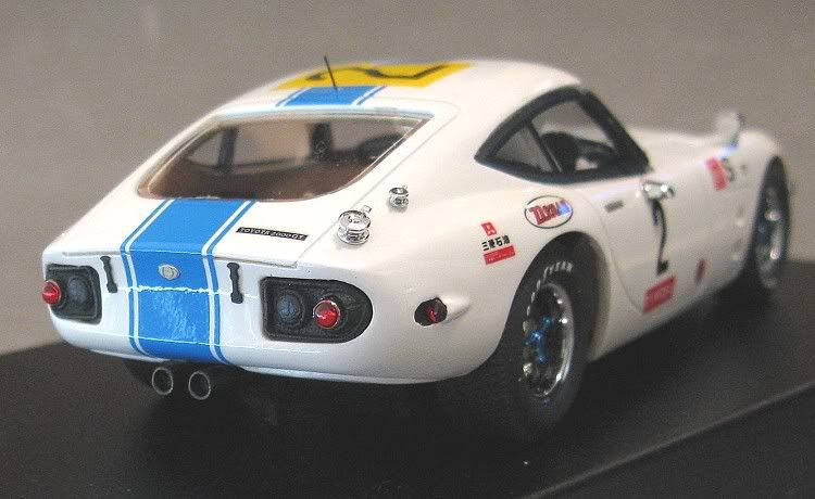

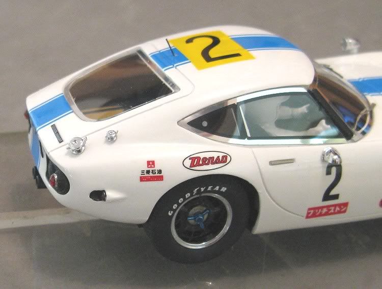

The model is every bit as good as some of us were expecting it to be. The best feature being the superb detailing; from the front lights and grilles, right back to the filler caps and the rear and side marker lamps. The decals are crisp too, no fuzzy edges or botched applications and all of them readily readable.
The clear parts are just that, and if pushed the only critical observation I would make is that the inline chassis compels the need for a half driver tray.

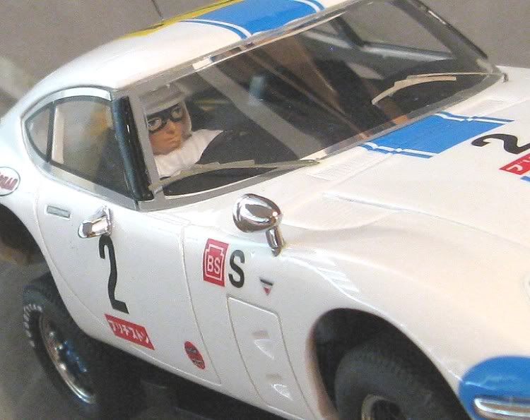

This has fine detail of the fuel tank seen through the rear screen, but the rest is quite ordinary, even to the point of no detail for the dash. The driver (the top half, anyway) is a familiar friend from some of Racer’s more expensive models.

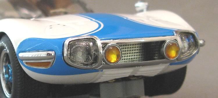

As with the real car no doubt, they have faithfully reproduced the anodised strips that used to finish the old style glass rubbers, and these look effective. Other anodised parts are the front quarter bumpers mounted over the flasher lenses. It has a very nice front grille and surround, etched in the finest detail, and to the sides and rear there are some additional features such as the wing mirrors. The Monza fuel caps are very tiny and very well done. Their permanency being the only unknown should the model be raced!
Whether it was intentional or not, the wing mirrors are removable and seem to be held in place by some sort of non setting compound. This will allow them to be removed for track work and for tear free replacement afterwards.
The wiper arms and blades are the finest of etched parts and no doubt one day we might see some rubber refills on them?? No? no matter. The whole model has a generous lacquer coat on it which makes the model shine well and no doubt will allow any scratches and marks to be polished out should they almost inevitably happen.

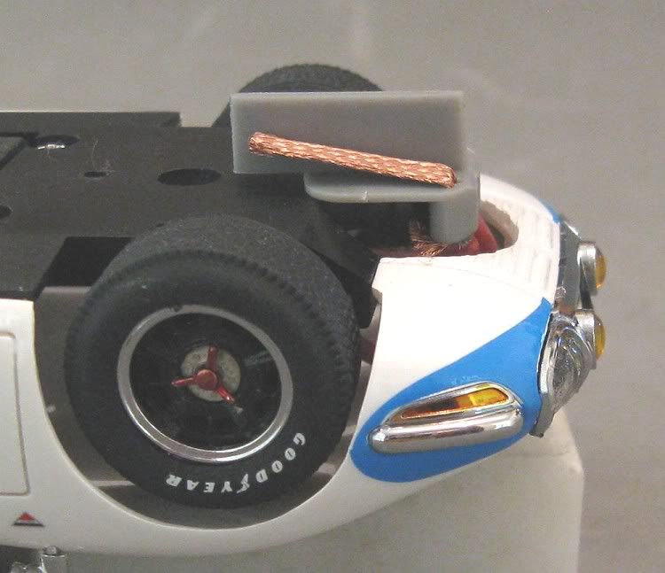

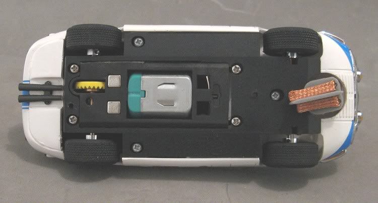

The chassis, although marked Racer looks to be a Slot.It rip off, much like the Racer range. The motor is the Slot.It MX 12 motor with a 9z pinion and the motor is very firm in its mount. There is no chance of it moving on the track. The guide is excellent too. Very deep and probably the firmest guide I have come across when it comes to sideplay and endplay. It beggars belief that other manufacturers can’t achieve this kind of fit?
The traction magnet is also reminiscent of Slot.It magnets in style and with the standard tyres it generates a modicum of downforce on Scalextric track. But don’t get too cocky, the height of the chassis above the track dictates that it wont be a Nissan 390 or a McLaren F1!! I would go so far as to say its more glorious moments may well be celebrated on non magnet tracks, especially board!

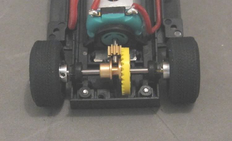

Wheels, my favourites, are excellent. Although the wheels are grub screwed alloy, the wheel detail is an insert, even the exposed chromed rim is part of the insert, with the tyre covering its join. Racer have gone to great lengths to replicate accurate detail for this model and this includes the wheel detail, especially the ‘knock off’ spinners. Red on the left and green on the right. On the real car this would allow anyone changing wheels in a pit stop to instantly recognise the left hand and right hand spinners, as they would also be left and right hand thread! One word of warninh here, the logos on the tyres are decals and become detached readily if you handle them, so keep your tyre changing to a minimum.
The tyres are quite soft and I can’t imagine that the diamond tread pattern will last long on the track. I can’t imagine it lasting long after its first sanding come to that! Axle bearings on the rear are the ball type which will self centre in their bearers, minimising axle drag. The front axle runs directly in the chassis material with no provision for adjustment, but they have allowed just enough clearance between the guide and the rails to allow the model to sit comfortably on some of the higher conductor rails like classic Scaley and SCX track.
Along with the slower motor Racer have fitted a marginally higher contrate (28z) and I would fully expect this model to be tractable on most home / medium sized circuits with the slightly taller gearing helping to get it off the line. Braid and lead wire material are standard Slot.It fare and there shouldn’t be any surprises from these parts if the model were to be raced.
The body is unusual in that it doesn’t come across as a resin body, yet it isn’t a typical ABS type body either. The way the three mounting points contain inserts tell me that it is some kind of resin. It is my guess that these inserts have been fitted because there is no pliancy in the body material, and to screw directly into it would see the threads strip out not too far down the road after a couple of body removals!
Also, the way the rear mounts have been modelled tells me the body has been formed between two or more ‘formers’ rather than injection moulded into a complex mould. Don’t misunderstand me, that doesn’t detract from the model one iota, but it does demonstrate that Racer are taking resin moulding to the next level! The twenty nine gram body weight, complete with trims and drivers tray, is testimony to that.
