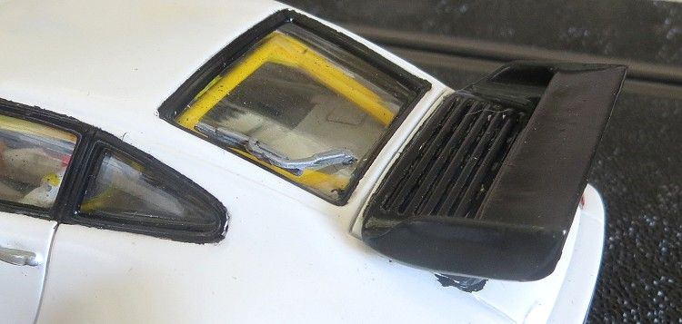

Probably the hardest part of the paint job was the window seal rubbers and trims. These are done in black but I defy anyone with or without a steady hand to paint them free hand. In the end I decided to mask them before painting them. Once masked and dried, I painted a thin layer of clear enamel along the edges of the masking tape to seal them. Also allowing a coupe of days between coats and not brushing too much clear onto the body colour or it will soften it. Again, once cured the black was painted on and left for a day before removing the tape. The idea of the clear coat is that if any paint bleeds under the edge of the tape (which it does), it will be clear and unseeable, the colour coat (in this case black) will not bleed under the tape because the clear coat has sealed it, leaving a sharp edge to the black (well, almost) practice makes perfect! The masking tape is then removed after a couple of hours drying time.
The headlights are from my friend Juan in Spain and they do come in several diameters. I only had the one size and had to file the edges slightly to get the lamps to sit in the recesses.
Front and rear screens masked for painting. The sides didn’t get done for at least a couple of days.
The rear spoiler was also masked and would also be brush painted. See the louvers above in the bodywork detail, these were masked from the inside to stop the driver’s tray glue running through them.
