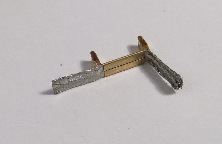

An braid
Next was the braids. In a non magnet set up the front tyres didn’t touch the track. The braid material was harder than most and the braids had jacked the model clear of the track at the front. The solution here was to carefully open the braid holders with the pointy end of a modellers knife and substitute the braid material with some softer compound tinned competition braid. The braid holder was then pressed back together again with a small pair of pliers. While I was at it, I fitted the smaller guide keel which I had hollow ground with a dremel to improve its tight corner capabilities.
The trimmed guide with new braids
The new braid material in place
The new braid
New braid along side old

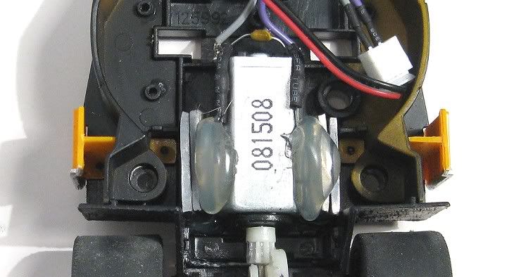

A couple of other things I wanted to deal with while it was apart was reducing the model weight at the front. I removed the front bar magnet. The screw to the polarity switch is removed and the switch and magnet will fall out. The switch was removed from the power input line by the two miniature plugs. The remaining plugs can then be pushed back together to restore continuity. The model was then set up on the scales again and I had saved about eight grams in all and shifted the C of G back a little way. Because the motor is able to move in its cradle if provoked, I decided to add a little weight either side of the motor. The hot glue was heated well and a small spot was placed to one side of the motor. Some pre cut lead ballast was then pushed into the hot glue. This was repeated on the other side. Once in place, the remaining gap down the side of the motor was filled with hot glue. Hopefully this will hold the motor in place also.
Ballast in place
This has brought the model up to ninety five grams! Is this too heavy for local racing? Only time will tell. If the model had been running on urethane tyres I might have been inclined to make it a little lighter, but, as the wheels are unusually wide for an RTR model I will be running on the tyres for a while no doubt, and the extra weight should do the trick.

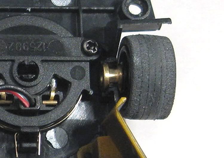

I had a chance to run the model on a board track this week and was still perplexed as to some of its habits. Juddering in corners and rattling noises to say the least. A further 'in depth' look was required. The juddering I attributed to the very poor rear wheel hubs. At first I thought it was poor tyres, (they are still poor!) but eventually I removed the body and checked the hubs. Sure enough they date back to the bad old days of plastic wheels and needed attention. This time I have run the model to half speed, and using the edge of a sharp modellers knife, I have scraped at the hub circumference. The illustration shows that while half the hub isn't being touched, the other half has lost quite a bit of material!!. I eventually scraped them ‘til the hub was concentric.
'Before and after' hubs
Another problem was the rear axle bearings. These had become loose in the chassis and was probably the cause of a bit of judder on acceleration. The axle was removed and I cleaned the bearing outer and the seat in the chassis. The axle was refitted and with the point of a modeller's knife I put a couple of spots of superglue on the axle bushes and watched it soak in to the seat. Even running an unloaded axle it sounded better.
