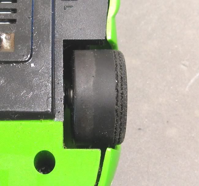

With the next pair of tyres I approached the problem from the opposite direction! I cut one groove in the outer edge of the tyres and tested. A minor but significant improvement was experienced. I then cut an extra groove besides the first and retested. The solution was at hand and along with radiusing the outer edge of the tyre, I had achieved a tyre which gave good straight line grip. So could I apply this to the Jag?
Back to the Jag tyres and not a lot to play with here, the tyres are barely 7.0 m.m. wide so there wasn't going to be too many groove. I settled for four grooves to start with and the tyre was mounted on a spare hub fixed to a dummy axle and installed in my drill press. The tyre /axle was spun up at about 1200 rpm and the point of a modeller's file was carefully applied to the tread area of the spinning tyre. Being careful not to overdo it I lightly pressed the file into the tyre which it cut quite easily. This created a rough groove slightly deeper than it was wide. Happy with that I cut another three grooves into the tread surface, repeating this process on all four tyres. The tyres were refitted to the model and it was packed up for the next race outing for a test.
Once on the track it was blatantly obvious the tyre grooving had been a success. The grooves had allowed the model to brake away controllably in the corner and still retain almost all its straight line speed. Problem solved. Being unconvinced by the many exponents regarding the 'tripod' theory of chassis setup, I have the Jag running on all four wheels. This contributes greatly to its corner stability too. But when tyres touch the track and unless the model has steering and independently rotating front wheels, there is an inherent risk that too much tyre contact will cause the model to 'snow plough' in corners. It is for this reason I have ribbed the front tyres too. This reduces the front end drag of the model and increases the model's front end ability to 'side slip' in corners. Minimising any unusual behaviour patterns caused by front end drag.
