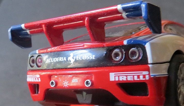

A replacement for the SCX Ferrari 360

But inevitably we get caught out, but what can we do about it? In the past I have had several classic Scaley models that have been deprived of their aerodynamic parts either by racing or by not having them when I purchased them! In these cases I have developed and fine tuned the art of creating “replacement” wings. This is achieved by copying the lines of the broken or missing wings in polystyrene sheet material.
A March 0-2-4
Also did the intake and a mock gearbox covering
the 4 X 4 rear wheel drive!
After some careful measuring it is a simple task to reconstruct a wing, piece by piece, to make it look as good as, and sometimes better than new! Spread throughout this text are some examples of my work. I suggest that for the most part they are quite effective and are indistinguishable apart from the real thing! I tend to determine the thickness of plastic required and then glue two thinner strips together. This is a type of laminating (a bit like plywood) which I feel gives the finished item more flexibility combined with strength, and less chance of breaking again.

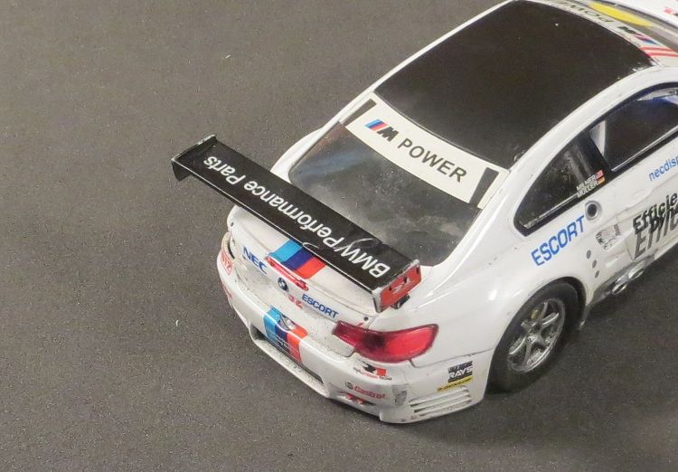

Just to follow on from the article I wrote recently on spoiler replacement, I had an opportunity to do the same again for a friend’s battle scarred Carrera BMW. Because the article was retrospective there were no construction pictures to illustrate parts of the narrative. This time I have been able to include some pictures which will make the narrative a bit more understandable.
The model in question has had more then a couple of years hard racing and there are several parts already missing from it; but, no matter how many light lenses, door mirrors and antennae are missing, nothing looks worse than a race car with a missing wing! It is the wing that tells us ‘this is a race car’; so it is my mission in life to restore all broken models to their former glory by creating a prosthesis which will once again allow them to hold their heads up high at the start line!

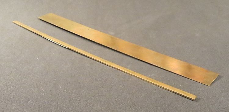

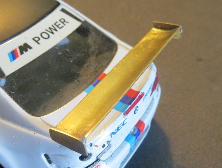

First up are the raw materials, these are in the form of brass strips available from the local hobby/RC store. Dimensions depend on the size of the wing to be built, but the first note I would make here is not to make parts too ‘clunky’, because they will look too beefy on the model. There is plenty of strength in flat brass for the task ahead, and the fact that the main part of the wing (blade) has a curve in it adds strength to the structure. For this wing I have used K&S brass, the blade being 0.5 m.m. thick and the pylons 1.5 m.m.

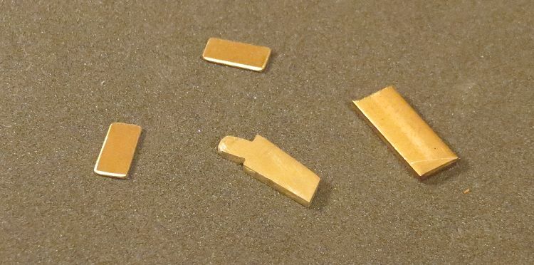

The first task is to measure the original wing or a pattern for it, and to mark and cut out all the individual pieces. This I did with a junior hack saw, leaving the fine cutting and final shaping to a Dremel type tool with some thick cutting disks. Offer each piece up to the original pattern frequently so’s not to overcut the piece and render it scrap. Once all the bits are looking good I test placed the pylons in the body slots and adjusted the angle where the pylon base meets the body. Because the material is thicker than the original wing, the slot had to be carefully taken out by hand with a small needle file. The tops of the pylons also had to be shaped to allow the blade contour to sit relatively seamlessly on them.

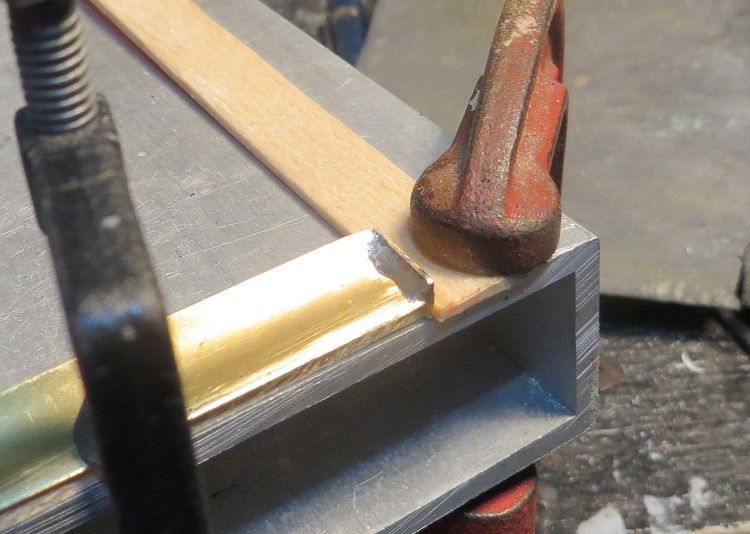

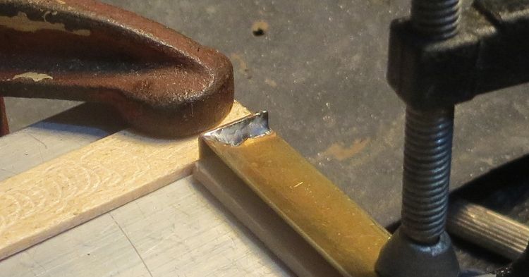

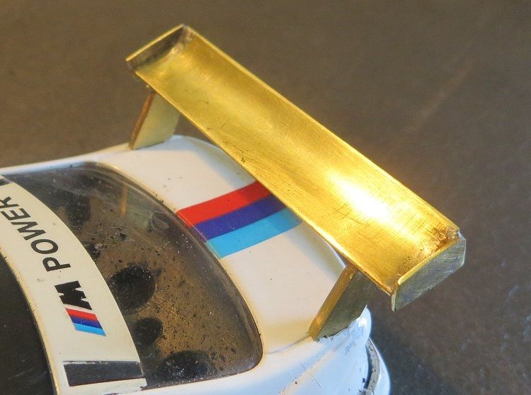

This is where it starts to get tricky; the one issue we have before commencing soldering is to assemble the wing in the right order, and to avoid an already soldered part dropping off while soldering another part on next to it! First up we need a soldering iron in the 30 to 40 watt range, or possibly even lower; and check the heat range of the solder; we aren’t looking for something ultra strong so a softer solder with a lower melting point can be used. All set to go? We need to place the parts on a large heat sink. Just by a stroke of luck I happen to have a couple of alloy square section tubes from a previous workplace.
First up is to clean everything. When soldering, fluxed solder will not flow evenly if there is oxidization on the surfaces to be soldered. All pieces will get the 1200 wet and dry treatment before turning the iron on! Lightly clamping the blade on the block, the finial is placed at one end, held in place by a lolly stick, and lightly clamped. Hopefully, if the cutting has been accurate the end will be vertical. Lightly solder by applying heat to the outside of the finial and applying the solder to the butt face inside. Once hot enough, the solder will flow freely and a small fillet of solder will appear in the join. Turn the wing round and repeat at the other end.

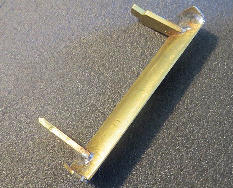

To fix the pylons the same technique is used, but because they are inside the wing ends I fabricated a small block of alloy and used this and two smaller clamps as a clamping jig to hold the pylons at 90º to the blade ( sorry, I didn’t photo this!). The blade had been pre-marked to ensure the pylons would line up with the existing holes in the body.
All going well and if you have been diligent you should now be admiring a soldered brass wing. Next step is to remove surplus solder from the more visible parts, especially on the top surfaces. Because of the thinness of some of the soldered joints it is beneficial to actually leave the fillets of solder on the undersides of the joints; this will add strength where it could be vulnerable. Last job is to use a round needle file to smooth the fillets if they need it and to tidy up in general!

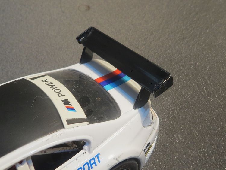

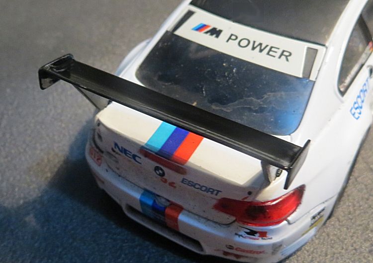

Once cleaned up and final adjustments have been made to the wing angle and general fit in the body, it is time to put a coat of paint on it. As always, I have applied a coat of flat pale grey. This helps to pick out any defects in the surface of the material to be painted.
Next is the finish coat. On this one I gave it a coat of satin black and finished off with a coat of clear gloss enamel. Normally I would have sourced some decals to help show it off a bit, but knowing the model’s history and treatment it will get I decided a decorated wing would be academic, so the wing stays in plain black!
Not too hard a job, but it does take a little bit of skill, especially with the soldering iron. The good news is that using very similar techniques you can create an identical wing using polystyrene sheeting of various thicknesses and some liquid styrene cement. Only thing is if you are a crash and burn merchant, it may well be as short lived as the original?
As always, give it a go, plastic or brass, and surprise yourself (and your race mates) !

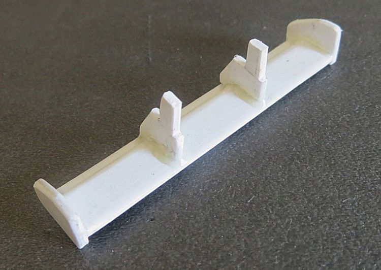

Another model which has recently become the victim of some hard driving is the Scalextric Tans Am Mustang. This lost its rear spoiler in an altercation on the track and the option was to superglue, or make something more resilient. The pictures should speak for themselves but the end result is a spoiler which should take more than the odd knock. This one I have fixed in place with aeromodeller's canopy cement, hopefully it will have more 'give' in it on impact.
