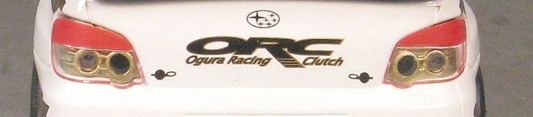

Search as I might I can not find detail of this model as a 1 to 1 on the internet, which leads me to suspect that it may well be a fantasy livery? But that aside, all other detail is real enough, the Model is of the Subaru WRX Circa 2006 and the decals are also very real representations of such prominent companies such as Snap-on Sparco, Kenwood, Alpine and others. And the main sponsor is ORC (Ogura Racing Clutch), a Japanese company who specialise in multiplate clutches for racing

Out of the box it is certainly a striking livery, not one of these modern liveries where reds and greens and blues and yellows are all mixed higgledy piggledy to affront the senses, but a very pleasant somewhat relaxing mixture of gold and white, always a good combination. Tasteful little moments around the model also cause the corner of the lips to curl; and chrome wheels!!! I’m not a chrome wheel lover, but I have no issues with this model.

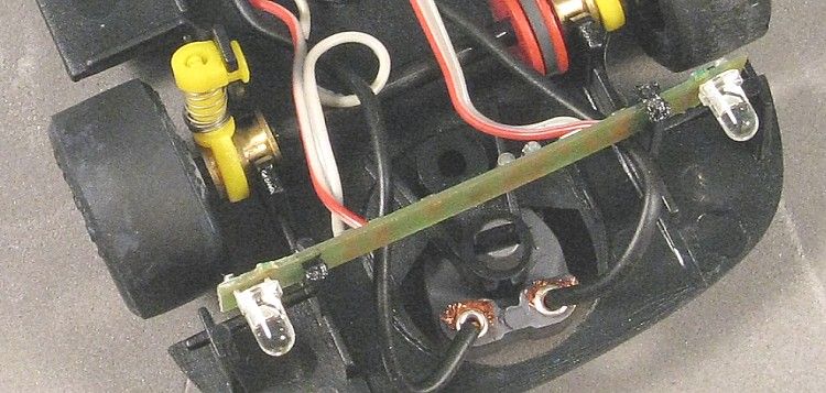

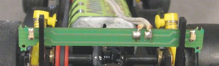

The first and most immediate change is that the model has lights... truly! I might have been living under a stone but this is the first Ninco model I have seen with lights! that I can recall. The lights are quite effective too. Ninco have gone to lengths to ensure light bleed is kept to a minimum, they have even fitted a screen in the front of the model to diffuse any extraneous light. While at the back the led's fit into the rear inner panel. One issue here when removing and refitting the body is that the rear light board becomes annoyingly dislodged very easily both ways! The solution? Maybe a spot of superglue on the brackets, but I think that would be a bit drastic. Maybe it’s best not to keep removing the body for whatever reason. The good point about the lights is the light they throw! They are basic 3 m.m. LED’s but they throw a definitive beam out the front and its interesting to see the model throw its beam on the landscaping as the model passes, Mmmmmm.....little things!
