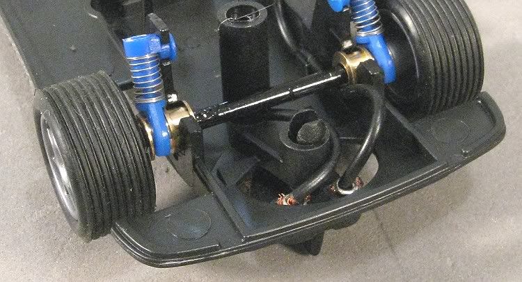

This is a Ninco ‘Sport’ model, and once the body is off we see that Ninco are persisting with their suspension system. I am not fully converted to this set up and still like my serious racers to be firm and fixed but I have to admit that I have a sprung 911 Porsche with an NC 8 which seems to go very nicely? I suspect the issues start when the motors get faster.
The first thing to test with the lid off is the motor, and as expected it is loose, and ideally it will need fixing in place by whatever system you prefer. The motor in this model is the NC9 Sparker, rated at 20,000 rpm @ 14.8 v (this translates to approximately 16,200 rpm @ 12v). Which is not breakneck, but certainly makes it highly drivable! And the lead wires are attached by the smallest of spade connectors which mean if you want to upgrade or downgrade the motor on race night, it is a simple matter of unclipping this motor and clipping the replacement in!
The magnet sits directly in front of the motor and I still would prefer to see the motors come with a longer pinion shaft to create a gap for the magnet in front of the axle. The Lotus Exige has a great little magnet and the model works well on a variety of tracks. This model could well be in competition limbo on Carrera track or ‘Magnabraid’ surfaces compared to some other makes; the magnet sits almost three millimetres above the track surface, and as strong as it is, it will need to be better.
Working to the front of the model we come across one of the most important aspect of any slotcar, and that is the part that keeps it in the slot; and again here, that particular piece is wanting! The guide is very sloppy in its hole and the slop is evident both side to side and front to back. Compounding this is the fact that the braid material is a particularly hard copper.
On its first outing I had trouble getting conductive continuity and in some corners the model would hesitate and go in fits and starts. After several attempts and a pair of flat pliers later I managed to get it to behave, with both braids flat and even. But the front wheels are still kept clear of the track with this braid material. Some tinned soft braids will be replacing them at the models next outing.
The right hand lead wire was adjusted too short and it prevented the guide travelling around to its right stop, but pulling it through the clip on the chassis was a simple enough fix. Another thing to keep an eye on is the rear axle mounting. The rear axle bushes run in elongated slots in the chassis as do the fronts, but I couldn’t help noticing that the right hand slot didn’t stop the axle from travelling too far and popping out!! This is the last thing you need in the middle of a race situation; and it could be something as simple as a deslot or being taken out that could induce this problem. This will need addressing at sometime.
